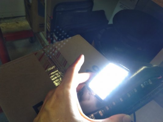

I always thought the puddle lights were kinda weak especially the white ones
So, In process of swapping to power fold mirrors. I had a broken puddle lamp and did some experimenting. lol
Painted everything black, cut a section for the white panel lights.
The turn signal lights are two put together. I thought they were longer when I bought them on ebay. The next one I will try and find the right size.
Came out pretty good. Going to seal them up tomorrow.

Cool, how you pull them apart? Would it be easy to just fix one that doesnt work anymore?
What was funny is. This puddle lamp was fine I thought.
I took my mirror covers off a while ago to paint them. When I pulled the puddle lamp out of the clear lens feel off. lol
I would think it's like heating of headlights and separating them. Maybe won't need much heat since it's a very small seal.
I only have one bad one, so if I want them to match. I will have to separate a good one. So I will let you know how that goes.
