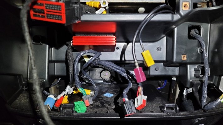

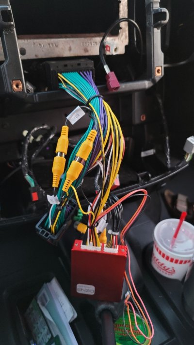

I recently installed the Customtronix Enzo into my truck that I have an 18' UAQ 8.4 Ram radio retrofitted in to. I have installed the keypad and rebooted the radio 4+ times after enabling dip switches 1,2,7, & 8. The radio reboot works when holding the #1 button on the keypad but when pressing any of the keypad buttons to display cameras the front camera screen does not display and the factory installed reverse camera does not work when pressing button 4. I do not yet have a front camera installed. However I have the factory installed backup camera and cargo camera. Do anyone have any idea what I may be experiencing or how to resolve the issue? Also, since my truck came with the cargo camera from the factory does the cargo camera dip switch need to be set to the on position or should I leave it off? I'm also wondering if the park pro will work and if the front camera will automatically come on when shifted into gear because my truck has a factory manual transmission instead of the more common automatic. I've sent Magnus an email and sent a detailed question on their contact section on their website. There is a before & after picture of the harness from me cleaning it up by wrapping it on Tesa tape to help make it look more factory. I would appreciate any input. Also used HD velcro to mount the dip switch box under the radio along with the video & aux inputs to avoid having to remove the radio for future cameras added or multimedia. 825582d2757bb45d4057d576498b6512.jpg4eaa3221c242afc742745834f4d90ab7.jpg318ef82675bd10fc673b078b160128ef.jpg
