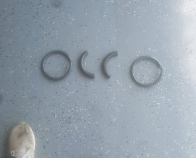

When I cut my coils in June, I measured around the outside circumference to see what the circumference was. All the research I could find was 1/3 of a coil was about 3/8" and 1/2 a coil was closer to 3/4". My circumference was right at 18" so I figured 6" around was 1/3 of a coil, 9" around was half of a coil. I cut mine 7.5" around. For my rear, I cut right at 1 coil.
I'll post a couple of pics so you get an idea. Sorry about the first few pics, had a broken lenses on my phone and it's the only angle I have pics in all 4 states.
Before Installation
Un-altered BT Kit
Modified Coils
Spring Scrap
With Cut coils and on 275/55-20- I did pick up 1/2" in fender gap with the drop in tire size, but the body also sits 1/2" lower.

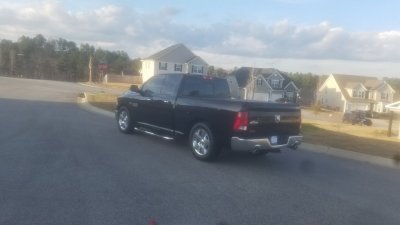

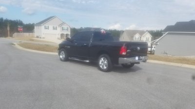

Here is a few more pics of how it currently sits.
20191027_151823.jpg 20191027_151806.jpg 20191027_151734.jpg 20191027_151718.jpg

Thanks for the info. So the rear still sits a little higher than the front?
Just a touch, but yes. If you want to get more level, I would try cutting about 1/8-1/4 coil at a time and see what it looks like. You can always cut more out, but if you go too far, you can't add spring back.
Before Installation
Un-altered BT Kit
Modified Coils
Spring Scrap
