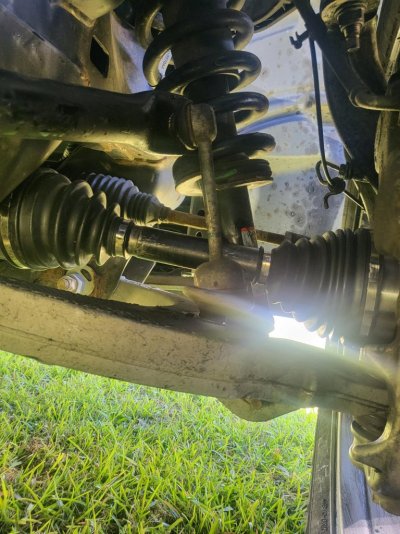

Here's a pic of the repair. Is this angle enough to cause problems. Found out it's a 2inch motofab level.

Doesn't look that extreme, but any lift will generally wear some parts quicker than if left stock.
Which boot was torn - inner or outer?

Outer boot. And that angle is a little off from the angle of the camera. I looked at it again once I was home on a flat surface and it's actually less of an angle than it appears in the picture. Must have just been a bad boot or something hit it. Buddy told me that sometimes the boot can come loose by turning the wheels too sharp in 4-wheel drive. Ever heard of that? Because I did that last week maneuvering my trailer at the landing. Who knows! It's fixed now and I'll keep an eye on the other one. I was worried that the level might have had something to do with it. I've had a level kit on every truck I've ever owned (and I've had a dozen, of every type) and never had an issue. And BTW, this 1500 is the best truck I've had yet. I love it. Never thought I would own a full-size truck with a V6 but don't really notice the difference. I am getting old and don't dog it like I used to though. lol

See all that grease all over your inner fender. That was your first clue something was wrong. Clean it off the inside of the inner fender with degreaser so it looks bare and clean again. Look there every so often for grease, if you see some bend down and check you joints.
