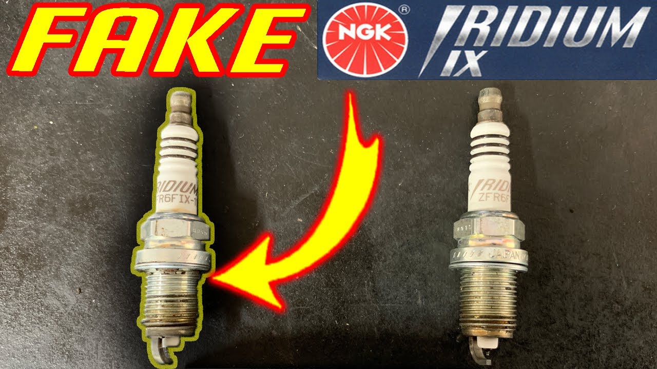

Do Not buy plugs off Amazon or Ebay,especially NGK's,buy them from Rock Auto or a local brick and mortar shop or the dealer.Your 12 will call for the older cheaper copper plugs.
The majority of NGK plugs on Amazon or Ebay are knock-offs and aren't actually legit NGK's.
A few minutes googling fake plugs will give you lots of information on fake plugs on both sites

Rick, is there a way to tell if you got a knockoff?
If you google fake NGK's,there should be several video's pop up on how to identify the fake ones Mike.
NGKs and Denso's apparently have the worst rep for being copy cat knock offs.
If the plugs are alot cheaper on Amazon or Ebay then anywhere else,good chance they're knock-offs.
John even has a video up,and how he got took with fake NGK's
I'm with you on that wild one.i don't buy parts period offline.i go too my local parts store or canadain tire for tune up stuff.
