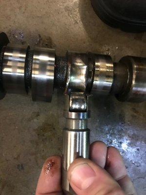

I did a 6.1 swap into a 67 Belvedere and kept getting a misfire code for #6. I changed coils around, still did it, installed new plugs from the get go then bought new coils from MSD. Still misfired on #6.
Tire the engine apart, cam was shot along with 2 lines. New cam and updated lifters, smooth as silk.
So I’m thinking you’ve got a cam lobe(s) ate up.

Does it knock? or tap more then normal if so could be a cam lobe/lifter like shown above. But first if i where you i would swap coils see if diff cylinder misfires same for injectors aswell as check plugs.
