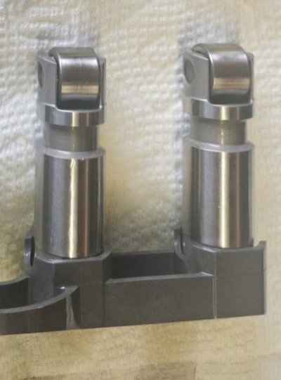

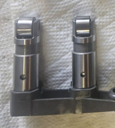

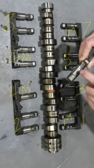

Does anyone have a diagram showing the correct installation layout for the MDS lifters on the 5.7 HEMI?
If anyone has a diagram or reference showing the correct placement of MDS lifters vs standard lifters, I would really appreciate it.
Thanks.
This is the best image I have (not mine)
OE MDS Lifters:
OE Non-MDS Lifters:

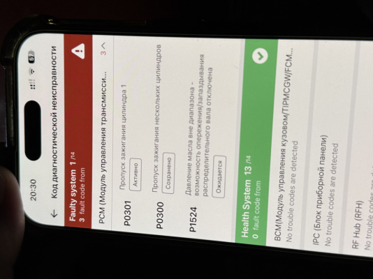

Hello everyone,
Here are the latest fault codes from today.
The scanner shows the following errors:
P0301 – Misfire detected in cylinder 1
P0300 – Random / multiple cylinder misfire detected
P1524 – Engine oil pressure out of range – camshaft advance/retard disabled
One important detail: the misfire appears when the engine is hot. When the engine is cold there are usually no misfire codes.
The VVT solenoid has already been replaced, but the problem remains.
Has anyone experienced something similar on a 5.7 HEMI?
Any advice would be greatly appreciated.
Thanks.

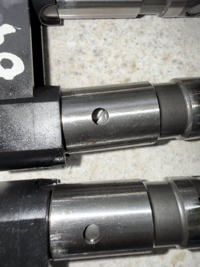

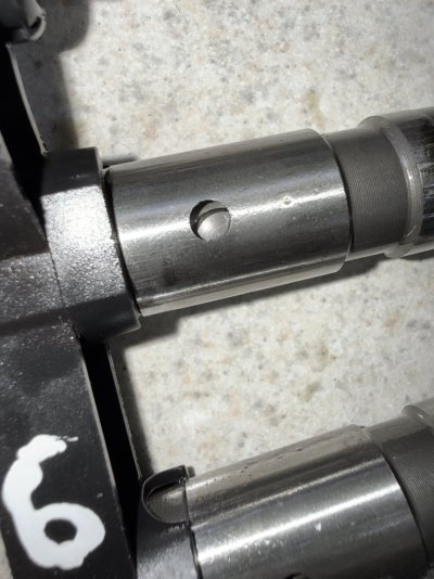

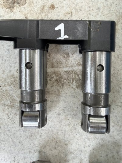

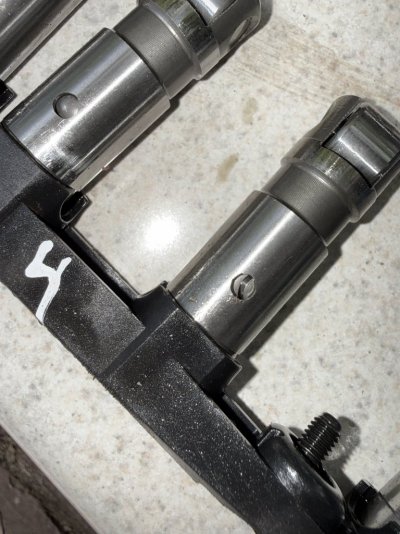

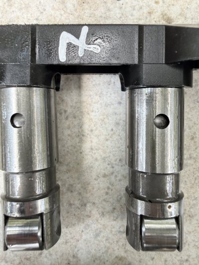

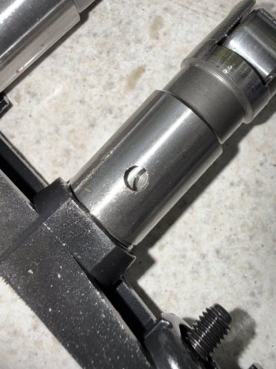

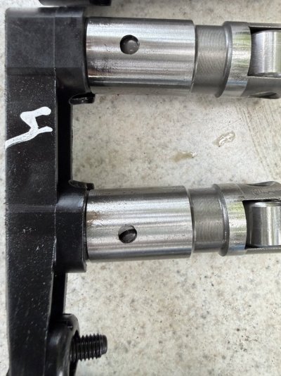

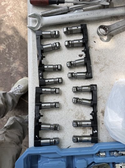

Hello everyone,
I have some new updates.
I disassembled the engine and removed the cylinder heads.
During inspection I found the following issues.
I am attaching photos — please take a look and share your opinion.
I would like to understand:
IMG_4166.jpegis this normal condition or not
  • could this be the cause of my problem
  • what should be done in this situation
Any advice or suggestions would be greatly appreciated.
Thanks.

EdGs
Nov 29, 2020
5,632
11,927
FL
I have heard with the OE MDS lifters that the pins don't have to line up with those holes, but I am not sure on that.
Hopefully somebody else will chime in.
Can you post a link with what brand these lifters actually are?
Ken226
Mar 12, 2017
2,328
6,052
Washington State
You are correct. The MDS pins in those pics are normal.
