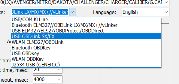

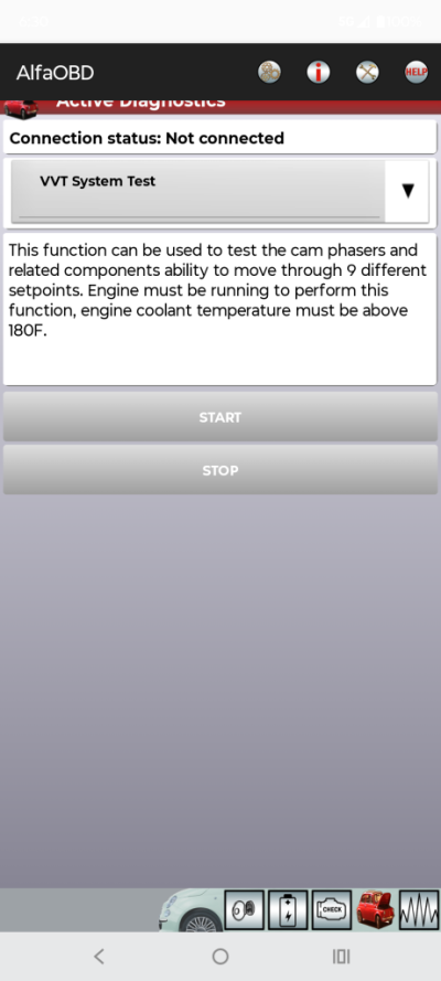

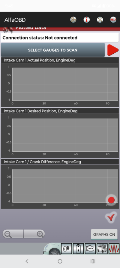

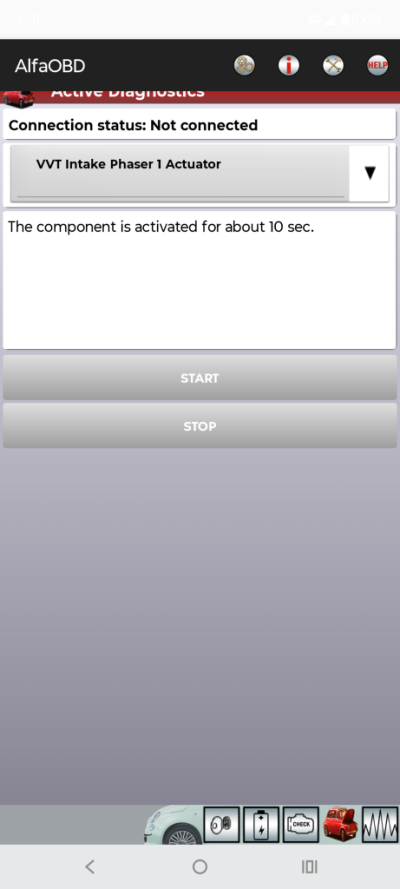

As for deeper scanning and live data diagnostics, unfortunately where I am currently located in a rural area of
Guatemala, this kind of advanced diagnostic work is not available. At the moment I only have a
basic mobile OBD scanner, which only reads fault codes and does not provide deep live data or advanced functions.
I am currently actively looking for a better scanner that can provide more advanced diagnostics and live data.
