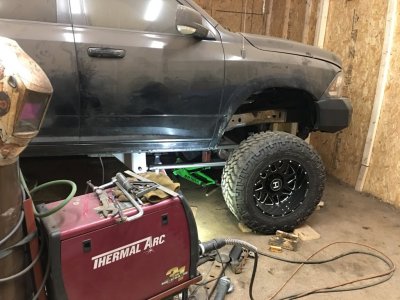

Axle is under the truck with parallel 4 link control arms I made. Deciding on how much ride height I want is a very hard decision. I want to actually be able to use my AMP steps, so I don’t want it too high. Wanting to go a little lower than how it sits in this pic.
BWL
Embrace the skeptisism
Oct 14, 2017
8,849
8,928
BC Canada
You should throw it up on the TOTM thread for October if it's back together enough.
