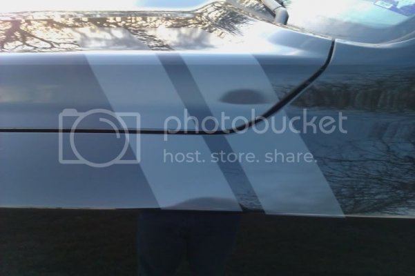

2nd- I then added the Challenger R/T stripes. had them custom made at a local sign store. Applied them myself using a bottle of water and windex, and a flat piece of plastic to use as a squeegy.

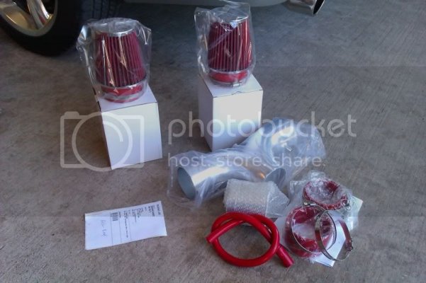

5th- Purchased a dual cold air intake. Universal kit.

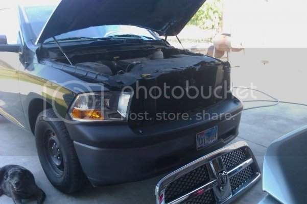

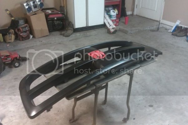

6th-removed my grill. Sanded the entire grill down. Primed it. Then laid about 3-4 coats of metallic black. Painted the logo red as well. Then clear coated everything. Also added chrome grill inserts.

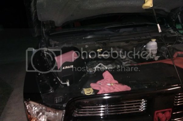

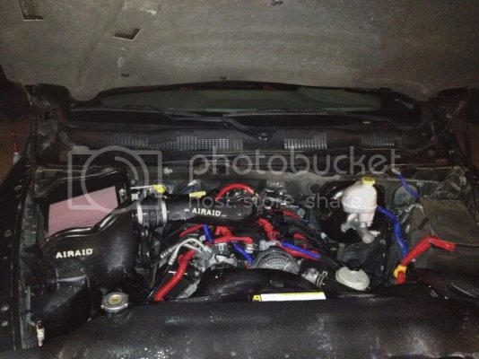

7th- I purchased an AirAid Cold air intake system along with a PowerAid throttle body spacer.

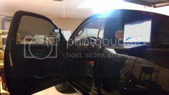

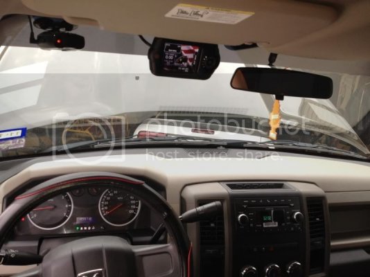

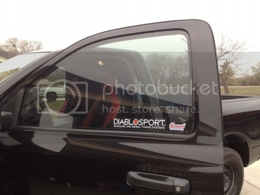

8th- I bought the Diablo Trinity for my Programmer, also at a later date i re-routed the wires to look nice and clean. which is seen in the second photo.

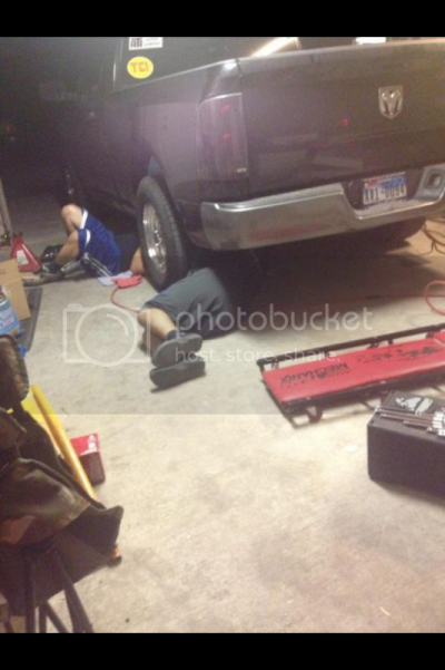

9th- Installed a torque converter from TCI, gave me about 2500 stall speed.

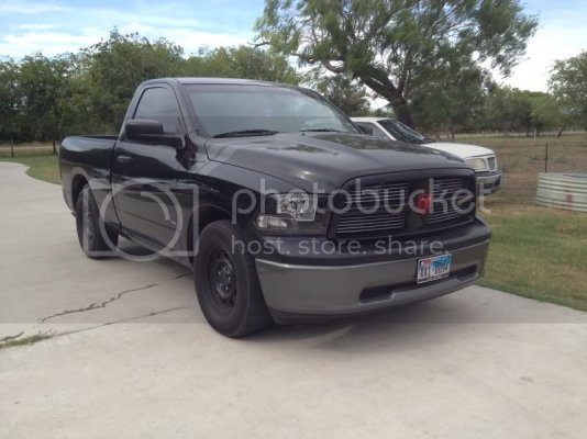

Here is sort of a before and after photo of the grill
This is my BEAUT now.

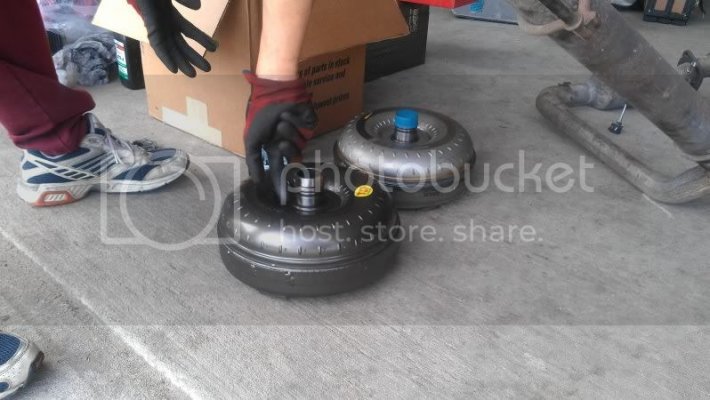

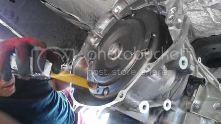

TCI torque converter

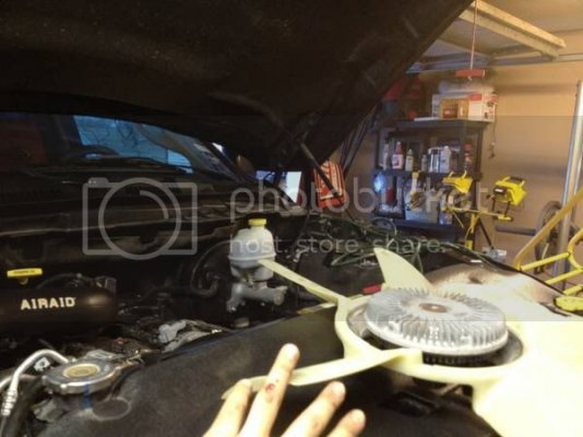

mechanical fan delete.

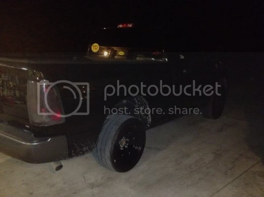

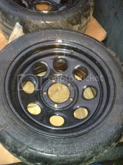

Drag radials.

Edge racing torque converter.

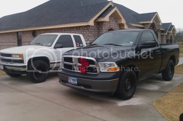

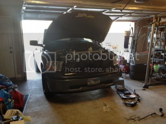

Fog lights that i installed behind the grill.

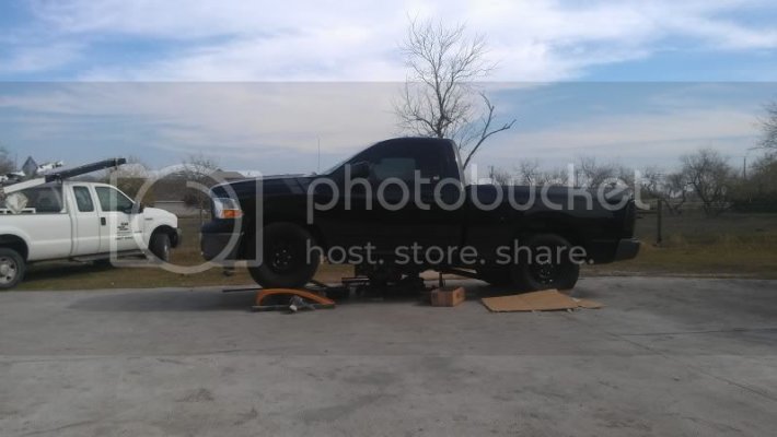

Purchased a set of R/T springs and cut them to lower the rear.

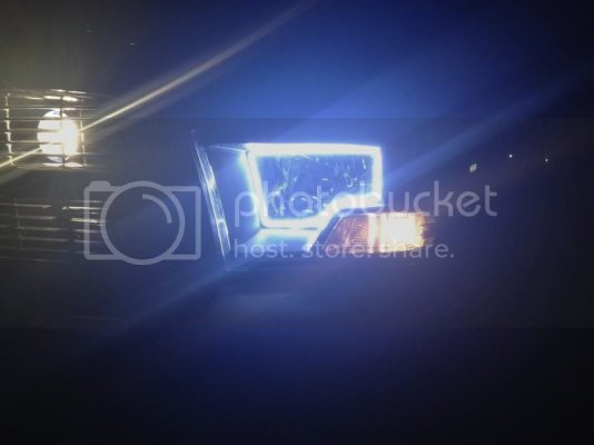

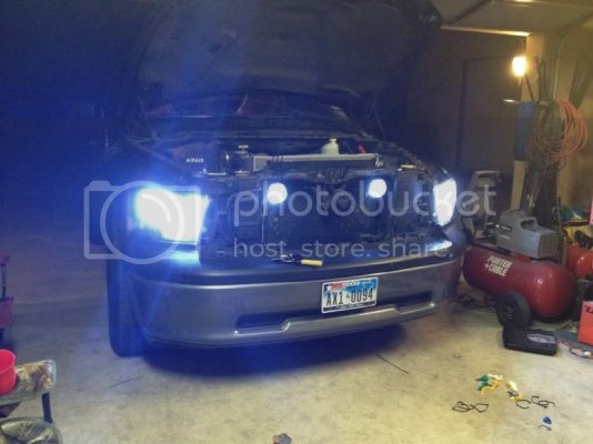

Headlights with HALOS from Oracle and AAC lighting.

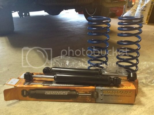

Purchased 2" drop kit for the rear from GroundForce

Very nice man. What steps and sand paper did you use to do the grill?
I want to get rid of my chrome one bad.

I used those green scuff pads. Scuffed the whole grill and be sure to hit the corners real Good. Primed it and added 3-4 coats. Then clear coat. Hardest part was mounting it up somewhere to work on it

Cool. Thanks man.
