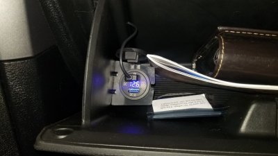

I ran the usb cable across the headliner down the a-pillar and into the back of the lower glove box. I didn't have to pull any of the trim except the side panel and a section of the door seal rubber. Behind the glove box there is a plug not used that I picked up power and ground to wire a 2 USB plug. I mounted the plug lower left in the box and ran the wires out the back. I'll try to get a pic later and add it here in an edit if you want.
This is the plug from Amazon. It has a touch on/off switch.
