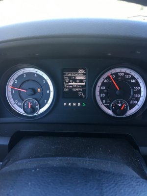

AF5A532A-EEA4-42E9-B401-A5E7ABA3E7EA.jpeg Here’s a picture of what’s happening. It shows range in km and when I set cc I get mph.

What does the digital speedometer show when not in cc?

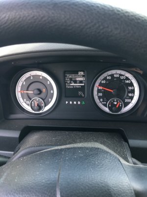

Here is a pic of the display no longer showing the cruise control speed. The odometer also disappeared as well.

My dash display looses the line under the info displayed on the screen and also looses the mileage all the time.
Although when I set my cruise control it stays in mph, unlike the OP where his goes to km.

Odometer not showing with the cruise control engaged is normal. The missing cruise set speed indication is not.
