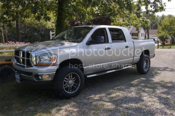

Can't really tell from the finished pic but the big dent is now missing from the passenger side. I'm happy.

It was actually one of the easiest things I've ever done. 4 nuts and the 2 bolts on each side are attached by a steel plate. All you do is un-plug the fog light harness, take all 4 nuts off, hold up on the bumper and slide the 4 bolts out. Lining up the new bumper was a little tricky, but once you have it close you can slide 2 bolts at a time in each side. Hold up on the bumper while you tighten the nuts for adjustment and you're done.
I actually think the de-badging took more time and sweat. Not to mention half the skin off my fingers. My cordless drill was dead so I barely got to use my eraser wheel.
