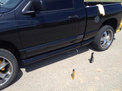

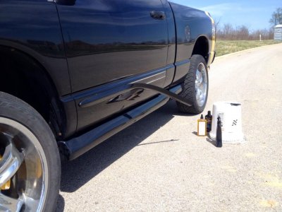

Well finally forced myself outside to get this project done. I was a little hesitant at first with it... but turned out great! Very Happy, I used the fishing line trick. Used the fishing line to cut behind the spears, and then went back through and rubbed the tape off with my thumb (got a blister to prove it). Then came back through with Goo Gone to take off any remaining residue. Then hit it with some Meguiars ultimate compound to get rid of any "ghosting" and oxidation build up. And the final step was some quick detail spray to add some shine and protect the naked paint till i have time to give her a proper clean. Total time was about 3 hours. Gives the truck a even more cleaner look! :rockit:

I will get a few better pictures tomorrow.

Thanks guys. Here is a bit better of a picture.
