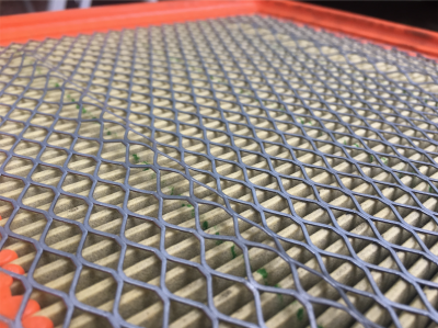

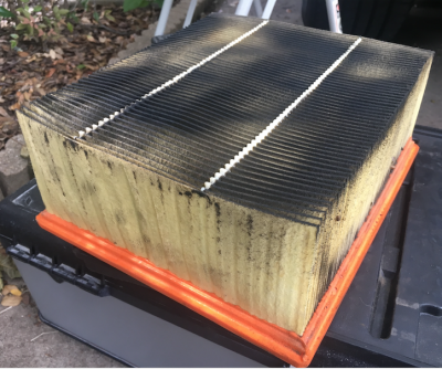

Checked the air filter just in case.
Time for new Air filter as a minimum

That air filter looks TERRIBLE. Have you run the truck with a new filter? I know furnaces much better than trucks but can tell you a filter like that can wreak all kinds of havoc on an HVAC system in a house including the thing cycling on/off and throwing error codes. I wouldn't do another thing until you put a fresh filter in and run it for a while (if you haven't).
I have not replaced the air filter yet. It has been at the dealership since the 19th except for the few hours I had it to myself. They alternate between not knowing what's wrong and just letting it sit in line for the tech to look at it.
