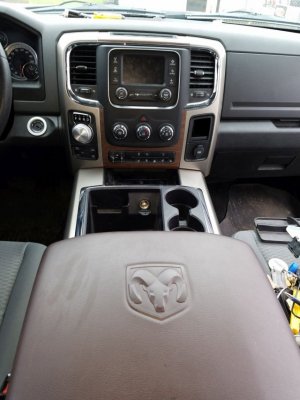

Installed Center Console
Okay so I swapped my center seat for the Laramie Center console I have. It is a temporary setup as it is the tan color scheme. My interior is the grey/black. I am swapping my center seat setup with a guy for his center console. Which are the right colors. Also I am missing some parts for this center console. So it is literally just sitting there. Still it will be easy to swap the new on in when it arrives.
All the Aux are working & Power outlet. My new CD player has power but radio doesn't see it. Someone mentioned their just recognized it I think. Maybe that was another thread. Is this one I need to add a code for at the dealer?

In another thread they said I just need to add the code. My radio is capable of adding it. So adding the code at the dealer should be all I need to do. It will be a little bit. I picked up this Laramie Center console but it is the wrong color for my truck. It also was missing some pieces. Found a member who wanted to swap his center console for my center seat. So we are swapping our complete center setups. He has the rear seat heaters so I pulled the wiring harness from my Laramie console to send with my seat. That way he'll have everything he needs to make all his stuff work. Including his CD player. Kinda cannabalizing this center console but thats fine. In the end I will have everything I need in mine. So for now I have installed it in my rig. Just so I don't have a blank space there. We both shipped out yesterday. So hopefully sometime next week. I can finish this up right. I'm about due for an oil change. So I'll try to get them to add the code when I go in.
