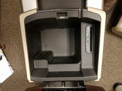

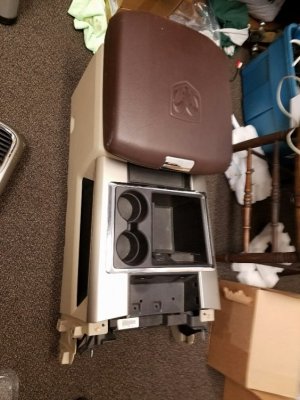

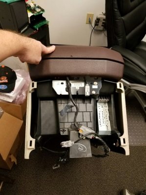

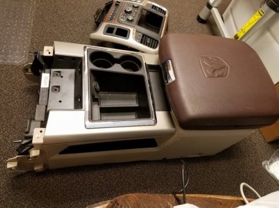

Okay came across this locally & thinking I should have just waited. Was local so I jumped on it. Not the right color plus not sure on the Bezel. I don't have the 8.4" radio. Can I even use this bezel? Plus this has the CD player in the console. Any way to plug that into my smaller uconnect radio? Jumped on it as it was the nice Laramie setup. Plus looking on Ebay seemed like a good deal at $500 for the both the center console & the dash bezel
I would love to upgrade to the 8.4" radio plus add the heated steering wheel. Just on a bit of a budget. I guess what is the best bang for my buck to upgrade to a center console? I currently have the 40/20/40 seat. While I have sat 6 in my truck before. I think I've used that seat maybe twice. I work out of my truck so really like the idea of having more storage.
Also this center console doesn't match my interior color wise. Really need the grey /black one. I also didn't notice it doesn't have the back cap with the vent's & a/c plug on it. Not to mention doesn't have the 2 side pieces that transition to the dash below. Also doesn't have the mounting brackets. Although I know I can just buy those.

If it's not the right color, I'd sell it. That's never going to look right with the interior color you have.
For the dash piece, you can swap in your bezel. Based on you having the smaller radio I'm going to assume you'll also need to swap in your switch bank and shifter/4x4 control.

Just looked at the one in my office. Looks like the center gray section can be unscrewed & removed. So I can just take the one out of my current to swap it over. Waiting to hear back from a yard right now with the right color center console for me. They had an 8.4 with no nav for another $400. At this point don't think I want to mess with trying to get everything working with the 8.4" swap
00R/T
Apr 18, 2016
1,278
808
CT
Most of the center console setups I am seeing online at the yards. All have the 8.4" radio. Is there a way to swap any parts of my current console to make it work? Can the centers be changed in the bezel?
Yes. Like I said earlier, you can transfer that over. You'll likely need to transfer your shifter and switches over as well because I'm assuming you don't have heated seats or 4x4 auto.

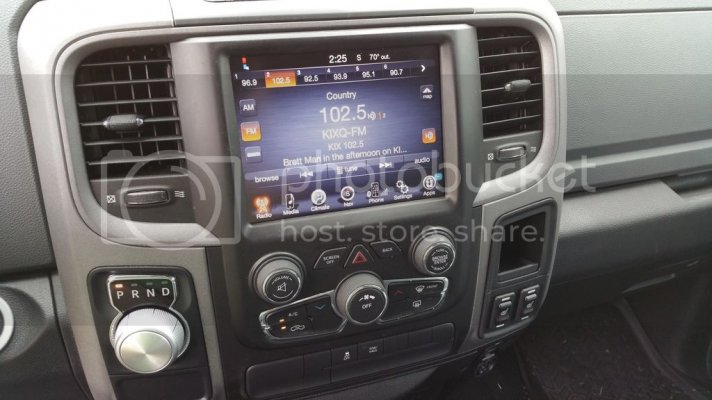

You can swap the shifter from the Laramie radio surround over to your Tradesman if you want. I have a Sport shifter knob in my 2014 Tradesman.
This is my Tradesman dash after I added some stuff.
I wonder what this button does?

Okay but since I only have the ra2 (I think) at this point. Would the wiring be there already? OR would I need to find a particular wiring harness?
I believe you just plug a wire into the back of the radio in the correct spot and the CD player gets detected automatically. Can you take a picture of the connections on the wiring?

What did you need to do to install the 8.4 radio? Is it the Nav unit?

Holy crap that isn't a plug & play deal. Definately going to hold off on that project. Anybody in Oregon who has done it? I pick this stuff up much better hands on than trying to read it. Appreciate all the good input. I definitely need to spend some time going over that thread. Was a little over my head first time through.
Post a picture of your current dash ...
If you currently have a 7 speed blower/fan control switch (vs 4 speed) in your truck then you are in luck and it is actually plug n play once you get the correct parts. (See Post 2 of the thread)
If you have the 4 speed fan, then it is a bit more involved but not as bad as it seems. (See posts 3 - 8 of the thread)
Note: there is a downloadable PDF in post 2 and 3 that assumes you bought the conversion harness which may help clarify everything (vs making it yourself from the posts).

I do have the 7 speed fan. Okay I definitely need to go through that thread some more. :happy107:
