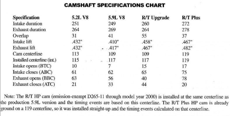

degreeing a stock cam
TJ marcus
Apr 14, 2021
30
Lyman, South Carolina, 29365, USA
94
5.9
I have a 2002 ram1500 5.9 stock cam. Since i am rebuilding the motor, I thought it would be good just to degree the cam while I am at it. What are the specs and where should I put the intake centerline?
