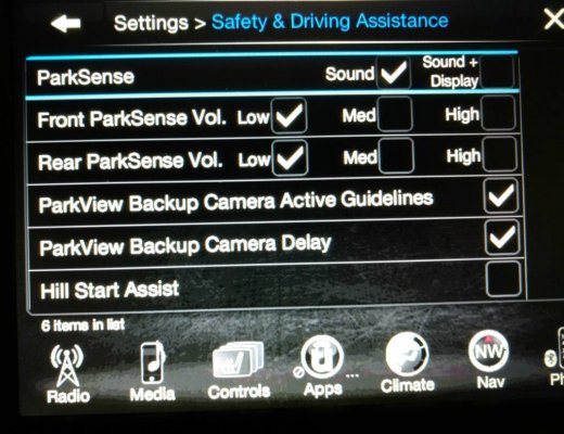

Nope..even if you turn the park sense off, there is nothing I found on the radio to stop the yellow "park sense disabled" warning when you put the truck in reverse.
In the radio, you have options to for just the sound warning or sound with graphical display for the park sense.8bbaa094b993a73a29dcd74cc089d079.jpg

I've noticed the same thing. You might as well leave them on with audio low. At least you get relative peace and quiet that way for the times the park sensors aren't in need of service.
