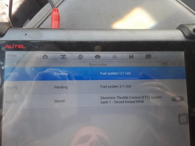

I have put a scanner on it and changed throttle body I attached a video of what it's doing. I Also a picture of codes after several resets. Once it starts driving and is under throttle it runs fine, however at idle or when it isnt under throttle it acts up. Figured I would ask in hopes someone else has experienced and resolved this issue.
