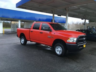

Pulled the trigger on a new ram 2500 today. I gotta ask are all manuals sluggish through second gear? 1-2 feel like I'm carrying a fully loaded trailer or something3-6 are nice and peppy. Is that just the nature of these trucks or will it improve as the engine breaks in?
Also any dos and donts? As far as break in driving, brands of gas, additives? And what the hell is up with that pos fuel cap?

Congrats, where are the pics? I hope you kept the addons and goodies from your trade in.

Seriously..... Pics man!! :).

Love the red. The bumpers would look better if the rims were black too. Can't wait to see what you do with it.
