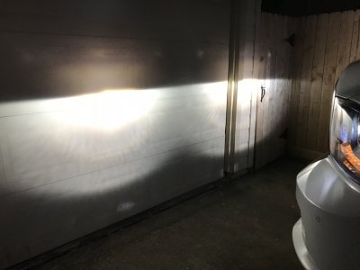

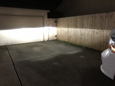

I installed a set of the new Diode Dynamics SL1 9005 LED bulbs for projector headlights on my 2017 1500. Everything fit under the cover even with the anti-flicker modules. I did have trouble with the anti-flicker modules, the wiring on the connectors was reversed on one end and the other AFM didn't even work at all it was DOA. The bulbs themselves seemed real nice and fit snugly, no issues there. You can see by the pics of the reflection on the garage door and fence looked promising, however once I drove down the street they kinda fell short, just had no depth or distance to them. So I give them a big :thumbsdown: and needless to say these will be returned ASAP.

wow like you said, in the garage they looked very promising, but outside looks like you just have fog lights on

Ya i was surprised, had nice hot spot and everything but just no depth. I’m lifted but I have my lights adjusted so when I’m behind someone the cutoff is right near the top of the trunk lid, not sure if that is the issue or not but it was fine with halogens. The pics are w/o any other lights on

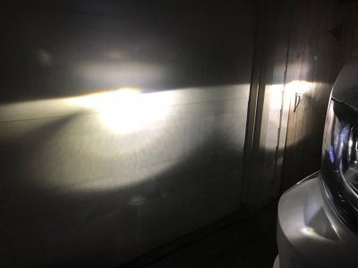

I installed a Morimoto HID 35W 5500K kit today from TRS, everything plugged right in with no issues. I didn't drill the hole in the cover, just made a notch for the wires to fit thru and filled around with sealant. These are much better than the LED SL1 bulbs.
The last pic is the SL1
