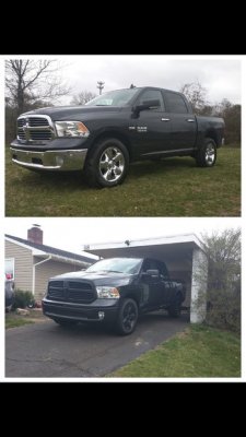

To replace the two back door handles it's easy but for the two front ones you will have to take the windows down.

Nice truck. what size are your wheels and tires?

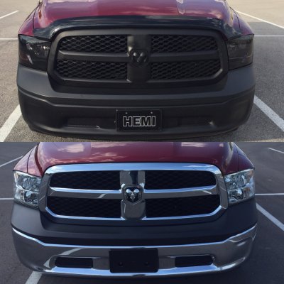

I plasti-dipped my bumpers and grill 6 months ago, so far so good
How many cans of dip did this require?
Also, any special prep required?
Rampaige
Nov 6, 2016
119
93
It took about 1 can per bumper and about 1/2 a can on grill (about 5 coats on each). Only prep was to clean chrome with soap/water, completely dry off, and masking tape off edges. I also let the can of dip sit in warm water between coats, that helps to keep the spray nice and smooth coming out, not clumpy.
