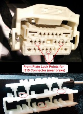

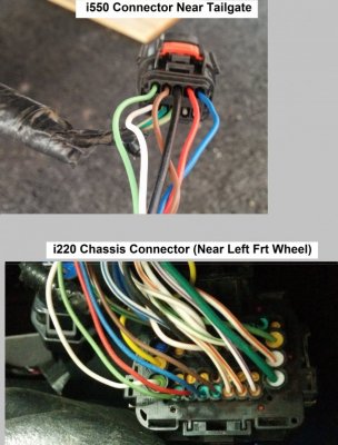

Well, I finally got it loose. Did a little bit of damage, but not bad. I took pictures of the final connectors (in case of troubleshooting) and also of the i315 Connector showing where the 3 lock points are for the front plate so others know what to go after with a small jewelers' screwdriver or similar. Prying at the sides helps some too but may cause damage. See attached.
@Jeepguy_1980, the cable lengths on the two harnesses were perfect for my SLT Crew Cab (short box). I think I may have had 6 inches extra on each which was easily taken up by shifting the harnesses before tightening down all the zip ties. Good.
(I threw a bit of heat wrap tape I had around the front section of the chassis harness closest to the exhaust)
Now I just have to get the "XAC" code flashed, but no available appointments at dealer for a week and a half. Next closest dealer is 45 miles away. Not sure if they have any availability or if I should just wait. Ugh.
EDIT: For those that want to reference JeepGuy1980's original directions for his custom harnesses (pictures are in the directions):
