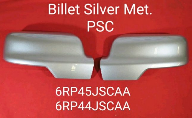

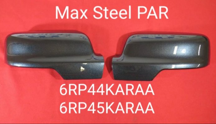

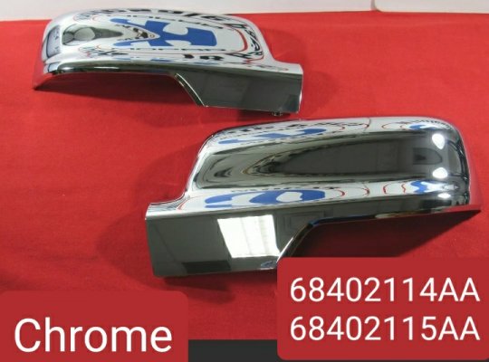

For those of you with power fold 1500 (puddle lights) Mirrors and want to change the Mirror Housing color without getting one of those cheap stick on covers...
(My 5th Gen Laramie has chrome covers & I prefer to have molded black or Diamond Black)
*** Contact forum vendor @AllMoparParts.com (Benny) for some of the best pricing around and usually a forum discount code of some sort.
Website Link: here.
PNs
LH/RH Bighorn + 1500 DT Pwr Fold Covers
Molded/Flat Black
68402098AA 68402099AA
Diamond Black PXJ
6RP44KXJAA 6RP45KXJAA
Chrome
68402114AA 68402115AA
Bright White PW7
6RP44GW7AA 6RP45GW7AA
Ivory 3 PWD
6RP44JWDAA 6RP45JWDAA
Maximum Steel PAR
6RP44KARAA 6RP45KARAA
Patriot Blue Pearl Coat PPX
6RP44RPXAA 6RP45RPXAA
Billet Silver Metallic PSC
6RP44JSCAA 6RP45JSCAA
Delmonico Red PRV
6RP44NRVAA 6RP45NRVAA
Granite Crystal PAU
6RP44LAUAA 6RP45LAUAA
