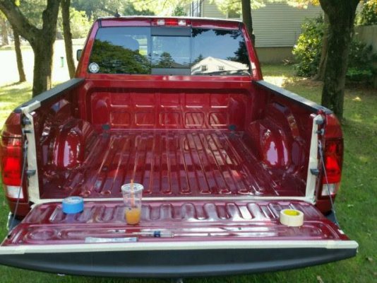

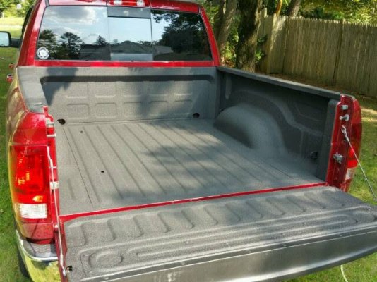

Mask the area you want to paint first, then scuff. As soon as you are done spraying the liner, remove the tape. I attached a pic of my bedliner that I did this to. Lines were crisp. 5c6d8ccc4e0c761860981d2949cb6030.jpg

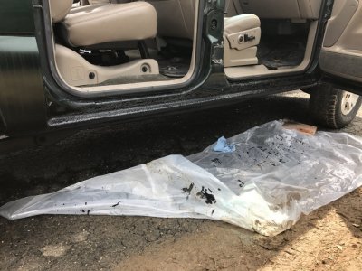

I used herculiner roll on, on my avalanche (dog truck) last year. I did the entire rockers
1C8589DD-D052-4670-98E0-929C4D7B9AB0.jpeg A9316791-78CF-4292-B6CB-B74C99234A74.jpeg

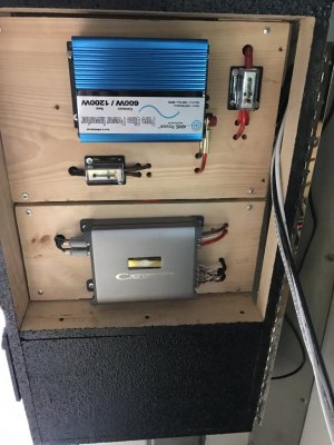

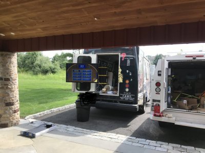

It’s holding up very well, I did the chrome bumpers too. No complants. I also used a lot of herculiner on a customers eagles bus to beer proof electronic cabinets and that’s working out great as well.

U havent used it on your Ram yet have you?Electronic cabinets?! Ya got me there??

55713908-4252-4F42-A0A3-34D22D9C98CE.jpeg A2404F7B-837B-4D1D-B3D6-8193A144F326.jpeg 8E29A86A-501B-4362-A07C-C11090EA92AE.jpeg
I did use is on my ram to paint the pinch welds I had to grind for clearance for my amp steps.
