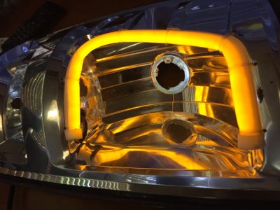

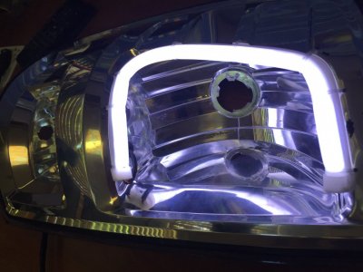

So, I have mine mocked up with 30 inch amber/white switch backs. I'm using the switch back to see if I can get the vehicle to treat it like a normal incandescent break light bulb. The switchbacks come with a chip on a harness that will cut power to the white running light to amber turn signal on. I'm experimenting by deleting the chip so both can be powered at the same time from the factory harness and reversed (amber for running and white for brake/turn). Here's what it looks like behind the lens...
Hypothetical Running light (Amber)
Hypothetical Brake/turn light (white)
EDIT: By the way, Scotch tape works great for the mock up! I stand corrected... EDIT to edit: Don't use scotch tape! It removes the chrome!
EDIT 2: Instead of deleting the chip that turn one off and the other on, I'm just going to change the wires on the chip to give me the desired effect. This "should" work...

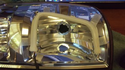

I used fishing wire to let the light through. We'll find out if it was a bad idea! I wrapped it around at each point several times so I don't think it's going anywhere. I also tied them together in the back for extra tension. The light transmits very well through the wire.
Edit: Notice the black mark on the right? Scotch tape took the chrome off! Use something else...
