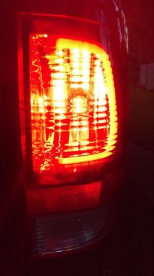

Looks good, I just think the amber looks funny behind the lens.
Agreed, but I think once its installed the whiter light of the incandescent will drown it out. We'll see...I really just wanted a dimmer light for running and Amber seems to fit the bill.

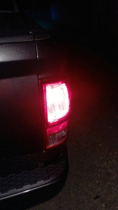

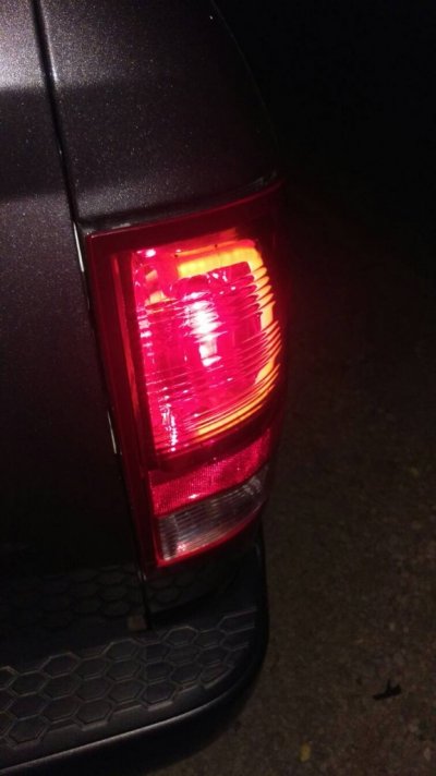

It worked! I'll get some night shots later...
Sent from my HTC One M9 using Tapatalk
SitKneelBend
Moderator
Member Relations Specialist
Jan 8, 2015
10,985
7,677
St. Louis
3.6 Pentastar
Night, really hard to take a picture that shows it on the flasher/brake setting...

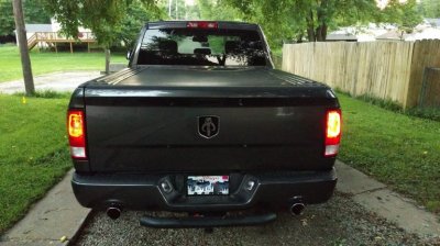

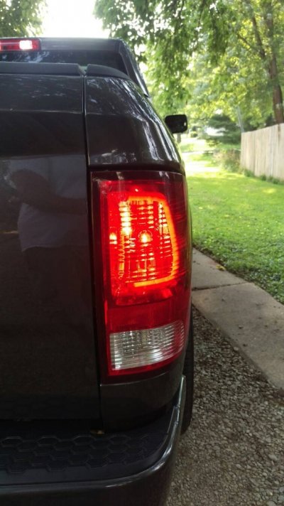

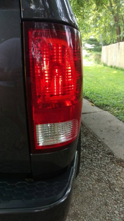

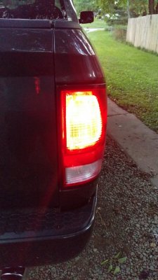

Ok, here's about the best I can do on pictures and video.
Comparison (left running/right flash)
Flash
Close up flash (attempting to correct for exposure)
Video (flash, return to running x2)

Not bad, can't really see it during the day. I wonder how it looks at night. lol
