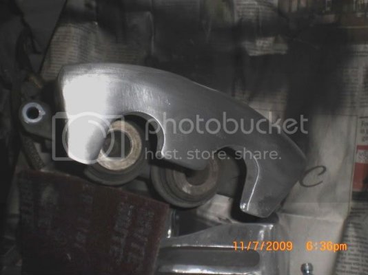

3. Now that your calipers are cleaned of all debris, you can start grinding / sanding them down. I initially used a mini die grinder with 40 grit sanding disc to clean up the rough finish, grind down the casting line and remove the dimples that are on the front of the caliper.
Pictured below are the calipers after disc sanding and removing the casting line and dimples.
4. Now that you have the casting line removed and the dimples are gone, you can continue using 100 grit sanding disc and then 150 grit sanding disc to start to remove any of the previous grinding marks and begin the smoothing process.

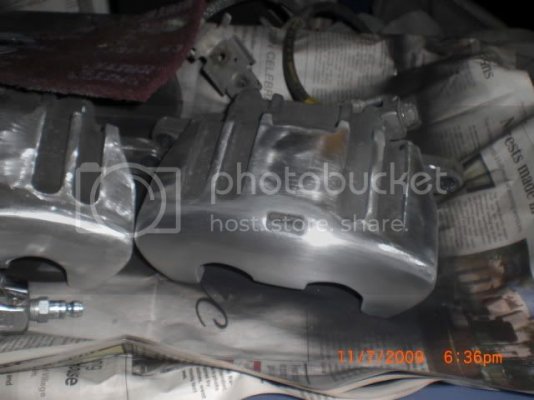

5. Begin by using 220 dry sandpaper to remove the last of the grinding marks
The calipers below are sanded using 220 grit sandpaper to begin removing the grinding marks.

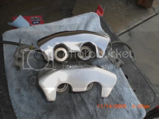

8. Now you should be looking at a caliper that is almost shiny, but not polished yet. This is where the bench buffer comes into play. If you do not have a bench buffer, you can use a small buffing wheel on a high speed drill or start to polish with polishing compound by hand.
9. You can use the white polishing compound bar and dress the buffing wheel before you run the caliper on the wheel to begin the shining process.
10. Once you have an initial shine, you can use the red rouge on a new buffing wheel as you do not want to use the same wheel for 2 different compounds.
Below you see the top caliper that has been polished with the red rouge and the bottom caliper has been wet sanded and ready to polish

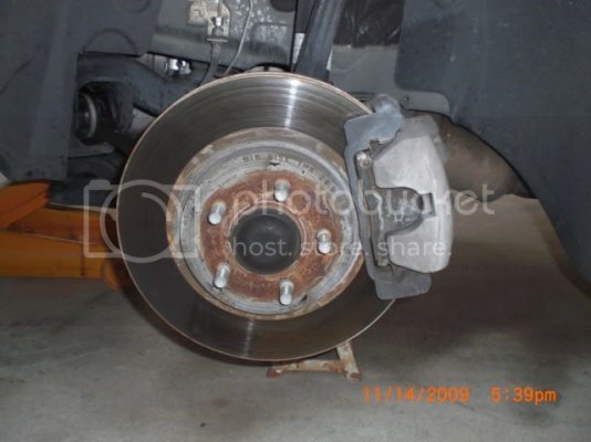

Here are my stock V6 brakes before I replaced them

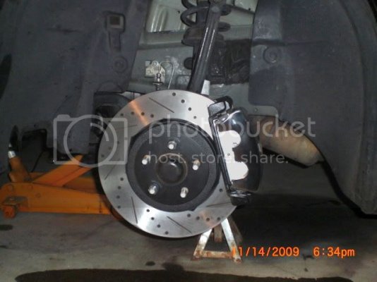

Here are the R/T Calipers and drilled/slotted rotors installed
11. Now that this step is done and you have achieved a shine that is satisfactory, you are done and ready to mount your shiny calipers back on your ride.
Here are the polished calipers with the wheel mounted. They really stand out now vs the stock V6 calipers. Plus the braking is greatly improved.
