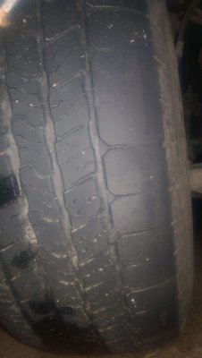

ok so I snapped a few pictures of the balljoints, again this is the driver side. is there any visual indicator to tell its bad? also took a picture of the tire and how its wearing....I'm gonna upload the pictures now, if I can figure out how..

heres the pics

You need to jack it up and check for loose parts. Take it to a shop if you are not comfortable doing that. That tire wear in the pic is not caused by bad shocks. It is camber wear or toe. Hard to tell by the pic. It can be cause by excessive play in the ball joints, wheels bearings and tie rod ends.

That kind of tire wear is definitely due to an Alignment issue. That being said, it does not mean there is anything to be changed, it could only be a simple case of wear and needs to be corrected.
