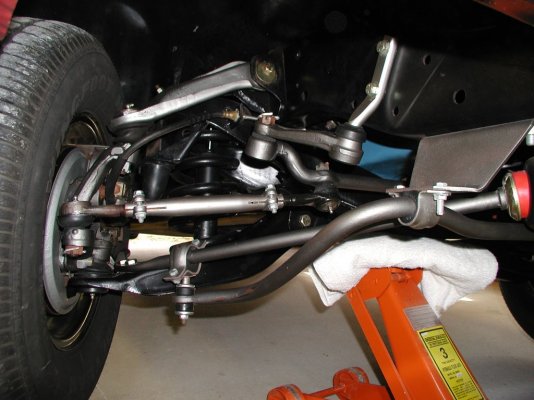

Here are a couple of pics of what the OEM Dodge part looks like.

I see. The link where the bolt at the bottom is attached, is sheared off and the upper bushing is gone. You may have seen that in the photo I sent. The link easily separates from the swaybar. It appears that the "rod" part of the link is fixed to the round "collar" that circles the strut. When I look at the 1972 links they have two ends that are identical. I tried to look in the Dodge official parts site but no luck. In one catalog (parts geek I think) they give the "bar" part another part number but it's not availble from them. What did you think of the ADDCO diagram?

The parts you have pictured are not correct, there is no pin or bolt. That the bushings would stack onto.
The two pictures I posted of the Left and Right side sway bar outer links. Fit your discription almost to a T. As I said I'm useing a Dodge Dealership Parts Counter , Parts Catalog for the Model Years 1986-1985 Rear Wheel drive full size truck and van. Here are pictures of some of my Mopar manuals, Its a large investment having these factory manuals on hand. But the information inside is priceless when you need it and cannot find it anywhere else. You get the correct part number and if the number has been superseded. Also paint codes, abbreviations of the words in the discriptions and directions on set up and use.
I have 4 old dodge trucks. I definitely don't think the pic you posted is OEM. not enough rust and dirt. :p
are those restoration pics? seems concourse level of clean
