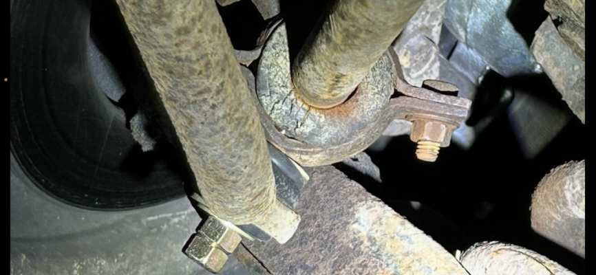

nope thats not it. I know the part he means, sorry I don't have/
My suggestion is this/ since the sway bar was OPTIONAL on those trucks I'd remove it entirely if only to get thru inspection, while I looked for that link. I'm a member of the Slant 6 Forum, as well and there's a guy there looking for the same thing.
I had the same issue with my Dodge D250 1986 . I scoured the web eBay used parts anywhere or anything. They are totally discontinued at least in the Midwest or the United States itself lol I use my HILLBILLY ingenuity. I got the old clamp off even though the broken bolt was still stuck on it that goes through the sway bar I flipped it upside down. I drilled a hole through the other side. I use a grade 8 bolt along with some heavy duty washers, some rubber grommets, and bushings that I got from Lowe’s improvement store I double nutted it and I took it down the expressway bounce around and a couple bumps purposefully and it’s holding up just fine. No more wobble. I can drive my expressway again. It doesn’t look pretty but it works. A 15 minute fix
