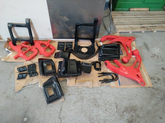

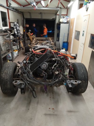

I'm New in this forum from Hungary. I've got a 2004 Dodge RAM 1500 5.7 Hemi Magnum 4x4 Laramie Edition. I started to renovate my car ( painting, suspension, drivetrain, chassis etc). Also I wanted to renew my engine. My question is:
I can get a procharger supercharger, what modification do I need to add my engine? What is the max horsepower which my transmission can tolerate? I don't want to build for race, just get a little + power. I thinking about to add also a comp cams stage1 camshaft kit, but i'm worry about both modification too much for my transmission, and also for drivetrain. Theese original system can acceptable just the procharger with boost under presure 14psi?
