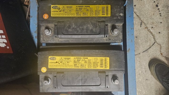

I bought my truck in 2019 and since it was a lot queen being shuffled around with questionable batteries, the dealer agreed to put in new replacement batteries. They were dated 2/2019.
Obviously you missed MOPAR REPLACEMENT batteries in my original post.
Actually I still have them since I used another pair for cores. One us still good, the other one will only hold 10 V.
