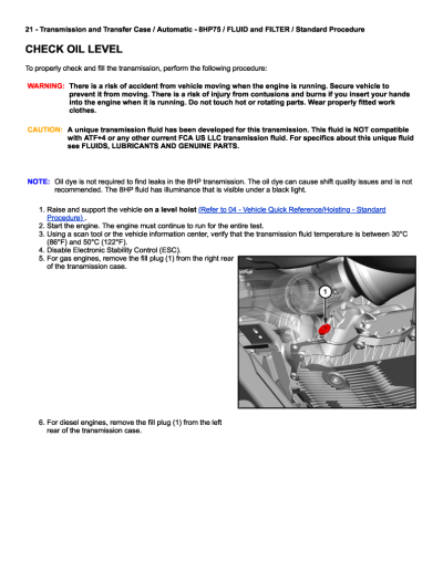

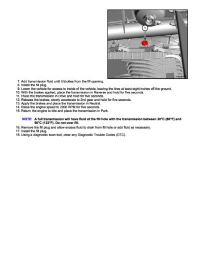

I know I'm late to the party here, but I'm trying to change the fluid in my 21 ram and wasn't happy with the internet search results so I paid the money to access the current service manual. It says truck frame level.
FLUID and FILTER Standard Procedure (CHECK OIL LEVEL)_Page_1.pngFLUID and FILTER Standard Procedure (CHECK OIL LEVEL)_Page_2.png
View attachment 550935View attachment 550936
These are the instructions that come with a "brand new" truck specific 8 speed bought through the dealer,and they specifically state to level the transmission,not the truck.
I would be inclined to believe the instructions that are included in the box with a new transmission are probably a wee bit more correct.Hell they even laminate the sheet,so it doesn't get destroyed,lol
