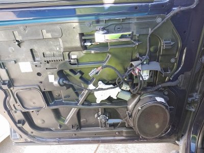

Door trim pieces removed
As simple to remove as I had read

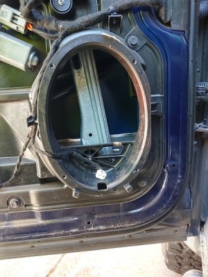

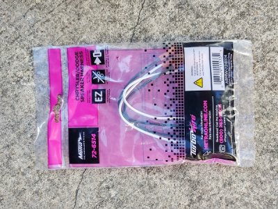

The adapters fit perfect

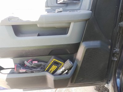

The speakers and spacers fit nicely behind the door panels
