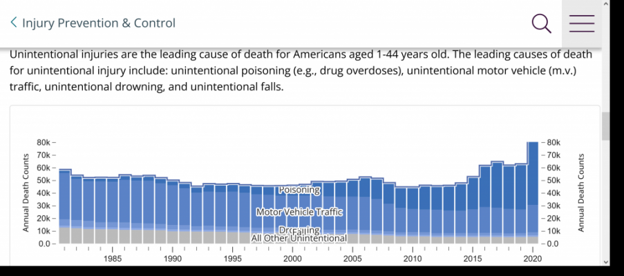

I am sure your response was intended to be in Jest cuase you are generally a pretty funny guy but: I have driven millions of miles in my life time. I have seen the destruction on our roads caused by the brain dead and people who only care about themselves. Up until 2015, when drug overdoses took over as the leading cause of unintentional injuries and deaths, and those are self inflicted, driving ranked as the top most dangerous thing most people ever do. Driving still isn't far behind..

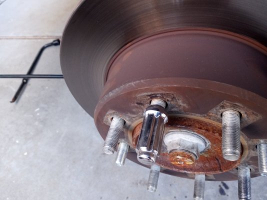

Had tires rotated on my '14 PW today and the shop cross threaded/stripped two studs on one wheel.
Have to leave tomorrow on a 700 mile drive. Not loaded or doing any towing.

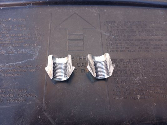

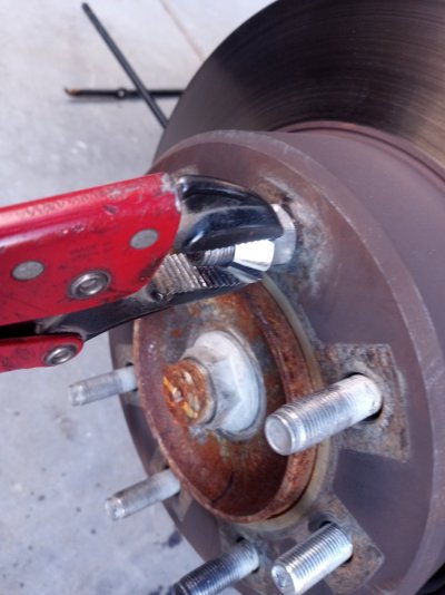

Ended up not needing to make the decision. My DIY thread chaser saved the day
A trip to OReilly got me a standard M14-1.5 lug nut; cut it in half...
...clamped it down on the good threads, added a little cutting oil, and backed it out through the bad threads...
...and viola'
