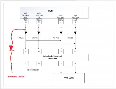

You might have to try doing a diode set up similar to mtnrider but taping your current turn signal which are being used as DRLs. You would use the diodes to keep power from back feeding into the opposite turn signal.
mtnrider
Sep 25, 2014
3,538
4,304
Georgia
I want to have the turn signals AND have my grill lights. Not use my grill lights instead of the turn signals.
I believe you could do this and get what you want based off my diagram? You could substitute the blinkers for the parks but it's the same bulb, just a different filament.
Enable the dedicated line in Alfa and tie it into the parks and add another line (with diode) for the running lights. That way when the dedicated circuit is one they are all on but individually they still operate as they should. I would also add another diode on the BCM side of the running light wire to prevent the dedicated DRL from back feeding the BCM running light circuit (like I did for the park circuit).
