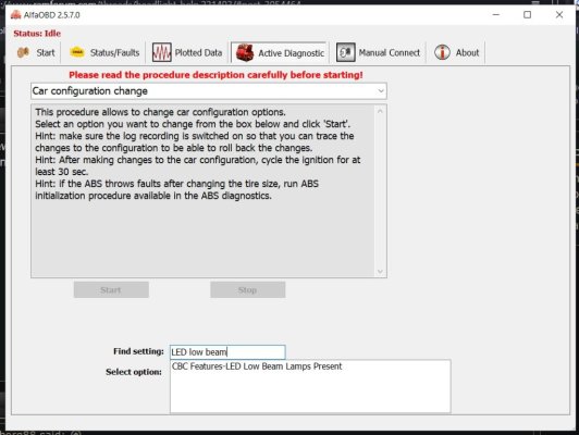

If you would like to try and sort out your LED bulbs, we will need more information.
Please post a link for the aftermarket housings and LED bulbs that you're having a problem with. The Projector-style housings are the best type for upgrading to LED.
Some LED bulbs are plug-and-play; some are not. Also, for a 2015 truck, you may require a few tweaks to have success.
I have both Auxito and Fahren LED bulbs in my truck. They were plug-and-play, but after about 6 months, I noticed an ever-so-slight flicker in one of the low beams.
After upgrading to LED bulbs in the reverse lights and third brake light, I set everything to LED using AlfaOBD. No more flicker.
One bonus for your 2015 truck is that you will not require a security bypass cable to use AlfaOBD.
RamDiver
Jan 23, 2022
5,570
11,760
Marlborough, Ontario Canada
2021 DS
My 2013 occasionally shows a headlight out on the dash since switching over to LEDs that are "Canbus approved."
That explains it. I have a 2013 and switched over to LEDs last summer. I get a popup that a highlight is out even though it's not. They also flicker slightly when starting up. They are marketed as "canbus approved" so I took a chance on them. Do you either have a link to the resisters or link to bulbs that work without issue?
If you already have the LED bulbs installed and they are flickering, that is a configuration issue that can likely be sorted with AlfaOBD. See the AlfaOBD setting posted in the previous post.
When our trucks are configured for incandescent lamps (halogen), they use a PWM signal (pulse-width modulation), which creates a flicker effect on many LED bulbs.
By changing the configuration to an LED bulb present, the PWM signal is disabled, and a steady DC power is supplied to the bulbs.
The bulb-out dashboard notifications seem to be a hit-and-miss, dependent on the specific LED bulb and truck vintage. A few members have lucked out after switching the BCM to LED present and had no further grief; others have required an end-of-line resistor.
As previously mentioned, I've had success with low-profile Fahren and Auxito bulbs, but I would recommend starting with using AlfaOBD to change the configuration to LED. You wouldn't be too impressed if you changed the LED bulbs and still had the same issues.
You should know that 2012 & 2013, I suspect, are the most challenging years to obtain success with LED upgrades. They are a complete hit or miss, so why not live on the edge and try it? :cool:

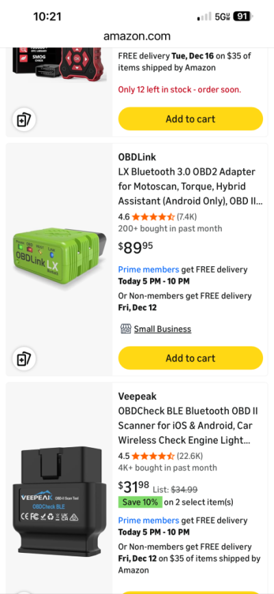

Carib909
Oct 26, 2024
13
Ca
3.6L
Will this work?
