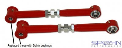

Definitely take Charonblk and Unbroken's advise over mine... However, I am having a hard time finding much wrong with my set-up, for off-the-shelf parts and street use (I drive it hard). See my parts list below.
I am going to upgrade to QA1s eventually... Not because I need to, but I want to. :)
If you go with the Spohn control arms, do yourself a favor and upgrade to the Delrin bushings from the get go. The pu ones suck bad.
