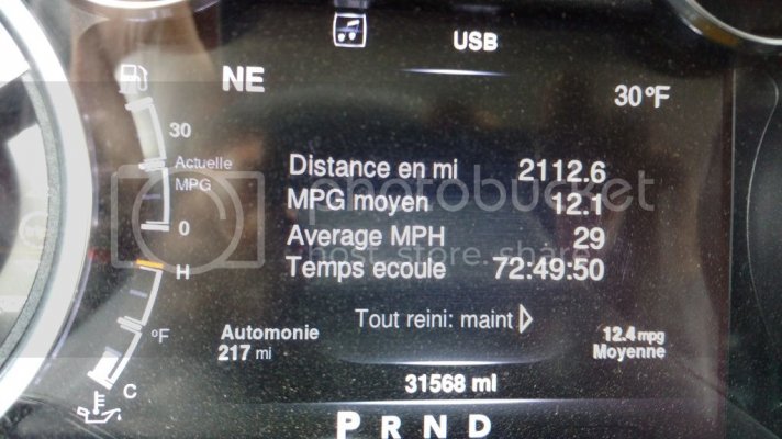

Since november my mpg have dropped really low.
I know winter fuel will drop, but it's my 4th winter with it , and it had never been so bad. Even if i'm very very light on the gas pedal I can't go over 12-13 mpg in city and 15-16 on highway.
I got a rotten egg smell sometime, is it possible that the cat's are gone at 30000 miles?
Can it be the cause of the sudden drop of mpg. Other than that nothing change, same gas, same station, tire etc...

No i never got any code.
I hand calculed few times, and the truck was almost right every time with minimal error.
I will take it to the dealer, hopefully they will found something.
