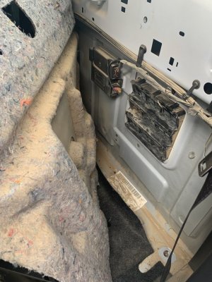

I added the cabin air filter and still have a dust problem until I search different forums. This is what I found when I took the back seat after to check the rear vents.
Part number: 68157351AD
The dealer whats about $16 while you can find the part online for $6-$10.
You will need to push on the 3 clips on top, push out the vent, angle it, then pull it towards the inside of the cab to get it out.

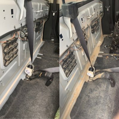

Here is an update. I installed the new filters in and clean out the dust as much as I could. I also placed a shop vac filter on the back side of the filter to help with the dust. I know doing this will have an affect on the AC/heat circulation. However, it does not change the pressure much when closing the doors with all the windows rolled all the way up.
