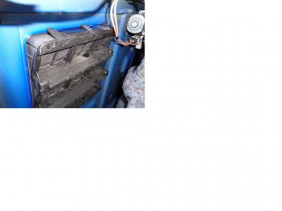

Same rear pressure vent leak on passenger side.
Found wet carpet under the seat and down under the sub woofer.
Could see the water leak trails below the vent.
Not much of a seal to keep water out, especially when washing the truck.
Tried sealing with permatex RTV, but it wouldn't stick to the vent's silicone rubber.
Picts are the drivers side, as I worked on it also.
Next packed some butyl tape around the vent's frame, made sure the vent seated snugly on the outside.
Checked for leaking water and no leaks now.
Pulled the 3rd brake light, no leak but top seal getting close to it on top edge.
