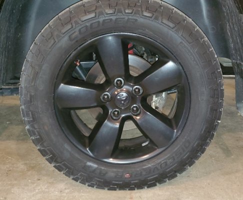

Put the Cooper's on mine last August. Stiffened the ride up a bit and feel more confident towing. I love mine so far 7k miles into them. Grip wise they have done great in all weather conditions (MN, so dry, wet , snow, ice, mud). I love the look of the XLTs as well 100% would buy again next time I need a set.f7b298c364d58c91a92e1e911be93ec9.jpg
