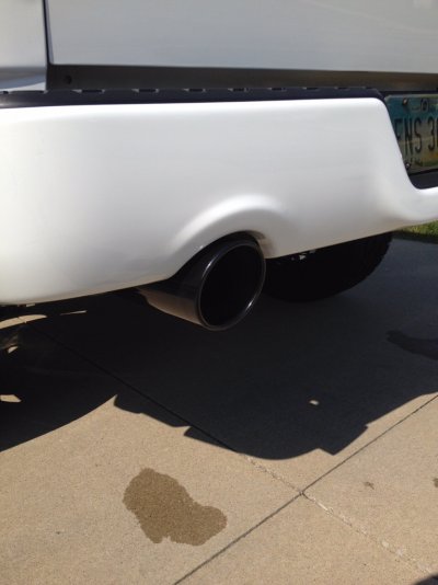

Yeah, but you get the 5" tips included with the full Catback ... And that's the way your tail outa look !!!ec985e8ec8ef65f660e79a0bdeddfed3.jpg

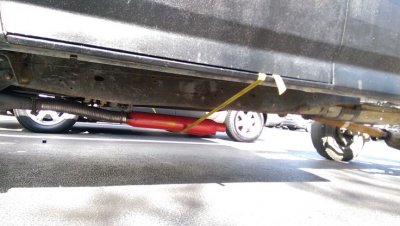

I don't even know what I have... It was on truck when I bought.. no stamps below.. It sounds like glasspack but idk
Sent from my SM-N950U using Tapatalk
abouttobeglue
Sep 3, 2016
647
320
Get a picture of it, we might be able to figure it out

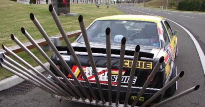

The first one is for better sound, the second one has to be special ordered for a RAM, but it spreads the sound around a bit. You can combine both of these.
