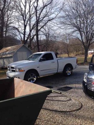

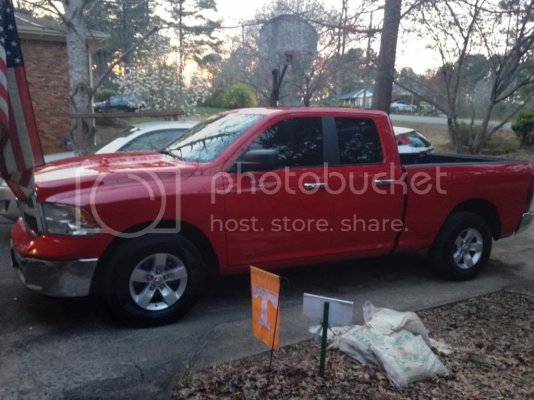

Here's mine.

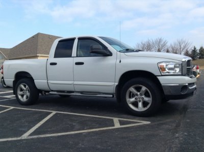

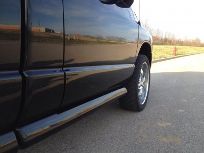

ImageUploadedByTapatalk1394367518.466838.jpgImageUploadedByTapatalk1394367535.174500.jpg
Here's mine debadged I also used goo gone and fishing line

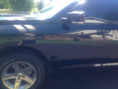

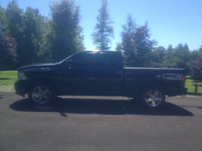

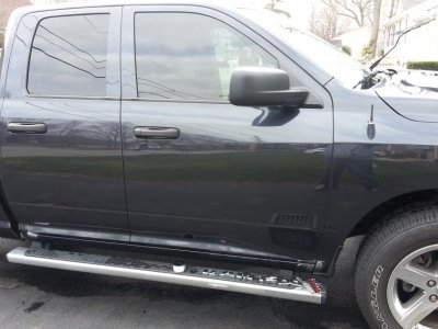

the first time I debadged it ****** my fingers up fishing line and a thumb, then I figured it out if ya can get a grab on 3m tape and pull out at a angle it'a come right off

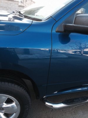

Goo gone works good. So does WD40. Here's a white ram debaged sorry it's not a crew cabthough

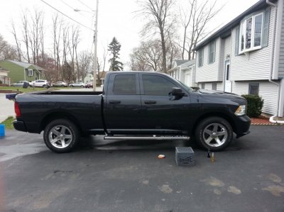

Finally got around to doing my 13

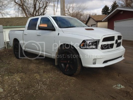

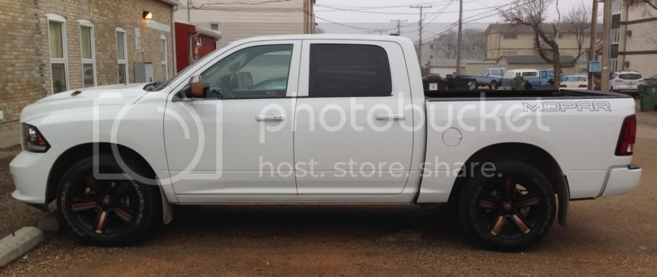

I would like to see a pic of some trucks that have been debadged... Preferably White Crew Cab
I have a white debadged crewcab. Removed the pillar tape too this weekend...among other things.
