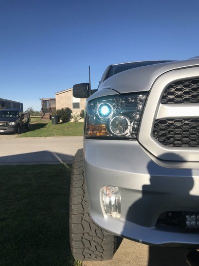

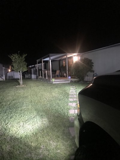

Got some pics. First one is with the opt7 led fog lights on and the second is without fogs
