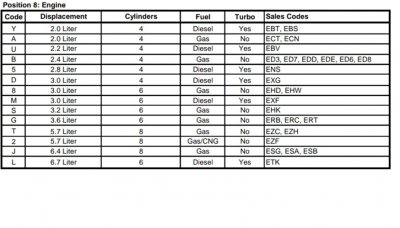

Good call, I do ! I thought they only made them with MDS after 2014 but obviously I could never wrong.
I found this info from another site so it is not my own.
"To be 100% sure check the 8th digit of the vin. If it is D then no MDS. If it is 2 then your truck has MDS."
Edit: not sure if this information is accurate for anyone but my truck doesn't fall under either of these suggestions.
Edit again: My 8th digit is a T. I finally found the chart of what it means
So from this FCA pdf from 2016. Now I need to know my sales codes of EZC or EZH.
Unless you work for FCA I don't see how the 8th digit signifies mds or no mds.
