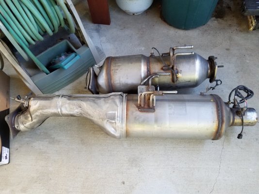

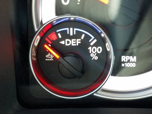

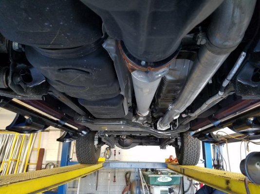

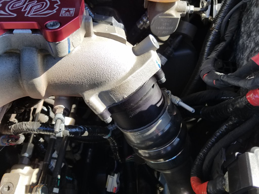

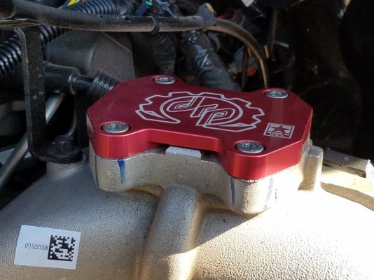

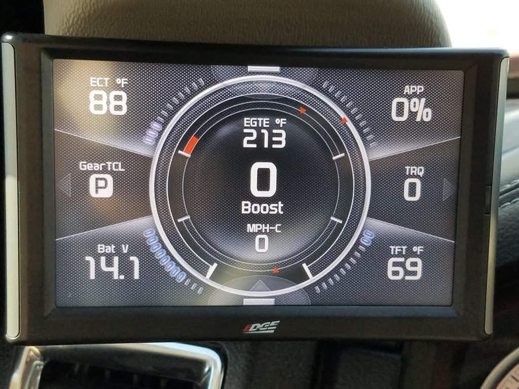

The emissions system in my 2017 Ram Laramie was a total nightmare. In less than 3K miles the truck went into limp mode four times and stopped...usually out in the middle of nowhere or off the side of a busy freeway...leaving me stranded and looking for a tow truck. Three different dealers were not able to fix the problem so I took matters into my own hands.
Here is my full delete list of parts & mods made to my 2017 Cummins powered Laramie.
4TH Generation 6.7L Cummins Delete & Tune Mod List
Delete & Tune mods
• Edge CTS-2 Insight monitor with Cummins unlock
• 13 – 17 EFI Live Dodge CSP4 tune package by PPEI / Kory Willis
• 13 – 17 EFI Live Dodge transmission tuning
• Cummins tuning switch CSP4
• EGR valve and cooler removal with block off plate
• Throttle valve delete
• Edge expandable EGT probe kit
• Pillar pod mount for Edge CTS2
Transmission mods
• BD Diesel 68RFE valve body plate kit
• Mag Hytec deep transmission pan
• ATS 68RFE transmission case support brace
Exhaust Upgrade
• FloPro 4“ cat & DPF cannister delete pipe
• 4” – 6” black exhaust tip with rolled edge
• Corsa 8004002 4” muffler – placed just behind the down pipe
When I did this the whole EGR assembly under the hood was removed. The DPF and converter cans in the exhaust were removed. The tuning by PPEI eliminated any codes that would arise if the PCM was not modified.
