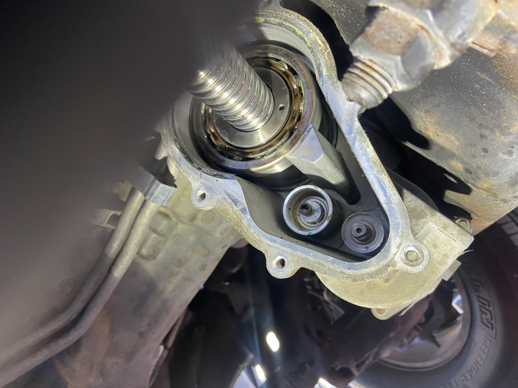

I have a 2016 ram 1500 with electric power steering. 3 Mechanics quoted me at $3000+ to replace the whole rack… Didn’t do it. Theres a belt inside of the rack, it was snapped in half. None of the mechanics I talked to knew there was a belt inside this thing. The belt is only 50$. Please check your belt before replacing the whole rack unless you want to chop up atleast a thousand $$$. 966B2A92-611E-4278-AF5B-717E678F836B.jpeg966B2A92-611E-4278-AF5B-717E678F836B.jpeg

Found another guy on facebook who was quoted several thousand to fix his rack,and i told him to check the $50 belt out,and that's turned out to also be his problem.He says he'll make a video of replacing it when he gets the belt,hopefully he also posts it here,as i sent him a link to this thread.

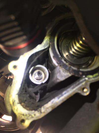

Just closing loop on my experience with replaceing my EPS. I tried replacing the eps drive belt first. This did not fix my issue. That was faily easy to do but wound up just being a waste of about $50 and 5 hours of my time. Next step was to find a replacement EPS Rack and Pinon. If you searched for one you know there are no cheap ones to be had. Found one at Buy Auto Parts, very expensive, but a lifetime warranty. Took about 3 hours to switch out. Return the core for a refund. No need to get the computer flashed unless you get a code MIL light. No way to know...just depends on the year and make of the replacement eps. Mine worked great. You do need to get a new front end alignment because you remove the tierod ends. Mine worked great just sucks due to the cost. Water in the eps due to a bad boot clamp caused my failure . tks.

Your post points out there can be several areas to inspect for EPS failure: Poor electrical contacts, Module failure, Water, Belt, Motor, Mechanical.
